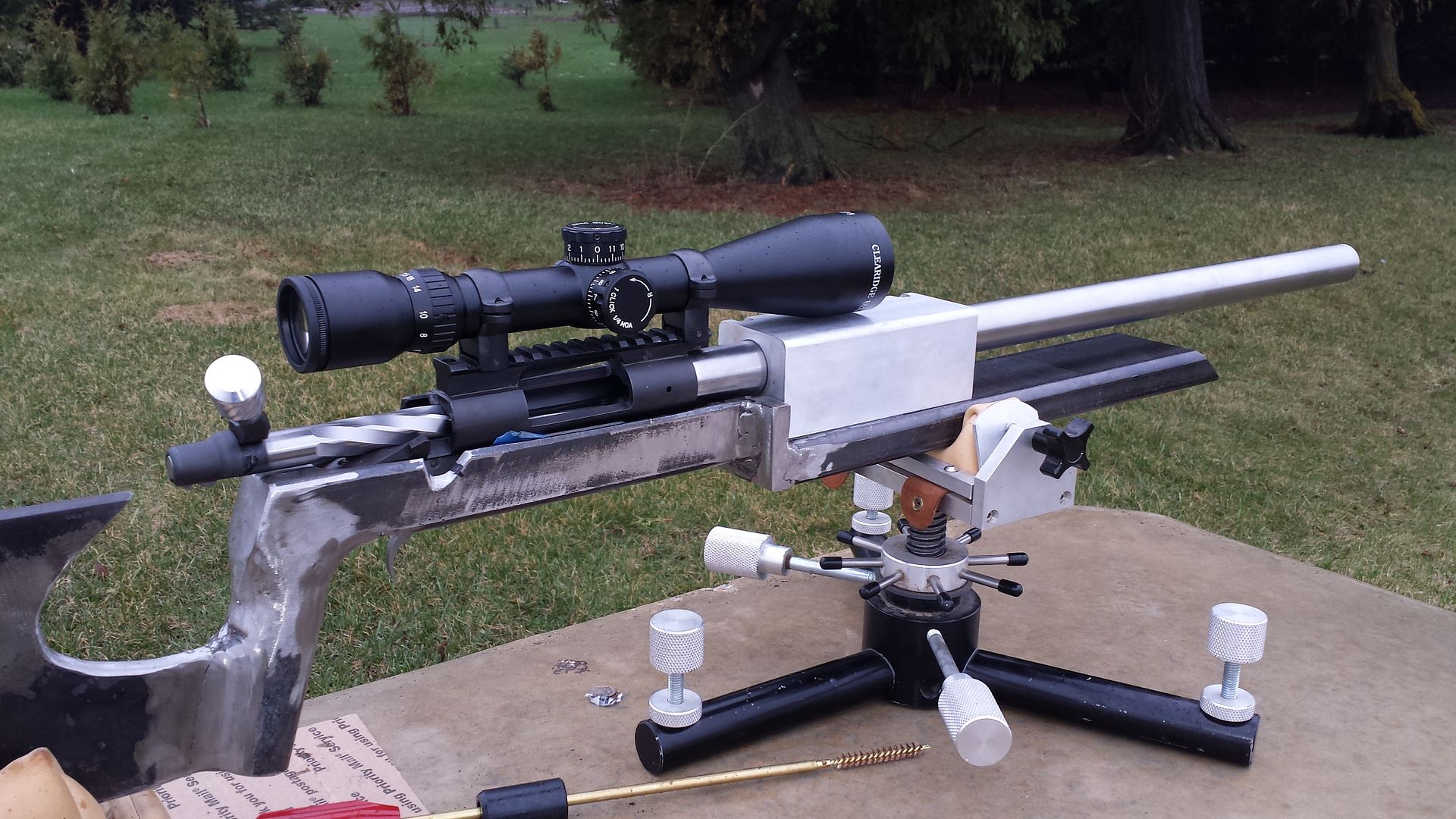

Made some time to get this monstrosity to the bench. It had rained all day, still spitting, but I was gonna get some shooting done or know the reason why. Prepped a few 17FB case, loaded with a mild load of 20 grs Exterminator and some naked 25gr Vmax for breakin.
It sets in the bags very well, it should weighing 30 lbs, lol. I left the butt-plate flat, I might have to change that, not sure I like messing with the front rest all the time for elevation changes. I understand for serious consistency , that's the proper technique, but in the field for PD's it's a lot handier to slide back and forth as needed on the rear bag to make minor vertical changes.
Recoil was everything I hoped it would be, just about zero! There is a little muzzle rise, but it's slow and gentle, on 22.5X at 100yds I can see the bullet impact the paper. Just hold and slowly squeeze the 2oz Jewel and sure enough, a nice 17 cal hole appears! It will be a phenomenal view, even at the higher scope power settings, if I want to zoom in on a PD at fairly close range to pick which flea I'm going to shoot off of him, I can do so. And NOT have to back off the scope power. I've gotten hooked on seeing the bullets impact from shooting my 17VHA. Redmist Like.

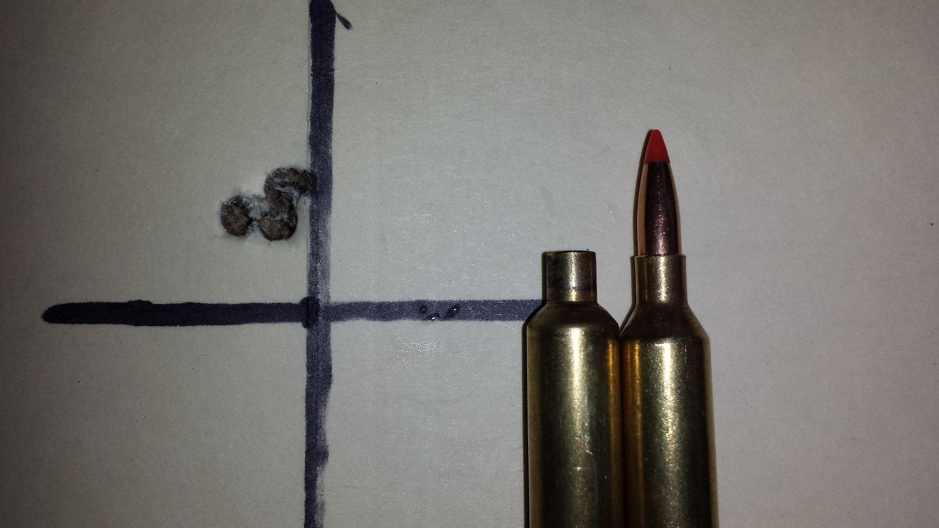

I think it wants to shoot also. These were shots 3-5, after getting it on paper. I'm pretty sure I coated this bore with the Dyna-Tek Bore Coat ( Have to check my notes, I'm slowly catching up with Hog and Waska re: CRS...of course I actually HAVE a job, so am busier..) The rain picked back up so I had to retreat since I don't even have primer on it yet.
Unfired 17 FB case right, fire-formed 17/23 SMc left. I really like this chambering for the increased performance over the 17FB and the lack of brass movement. In my walking rifle, a CZ in 17/23 Smc, I can go 3-4 firings just using a Lee Collet Neck die for resizing. A huge advantage, IMO.
All in all , it was a successful debut. With the view destroying recoil enervated , my major goal was attained. Now to do some final mods, fit a wood cheek piece, trigger guard, paint etc..
